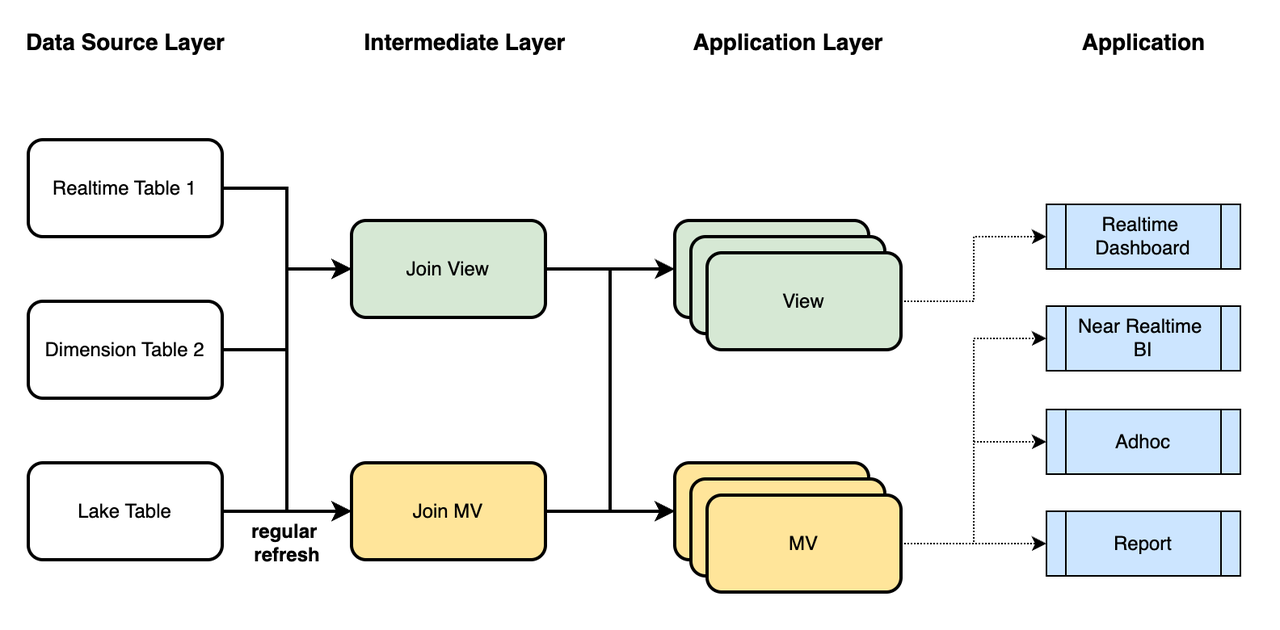

In real-world situations, you can perform data modeling by combining the usage of StarRocks' views (logical views) and asynchronous materialized views as follows:
- Use views to associate real-time data with dimension data, and use materialized views to associate historical data from the data lake with dimension data. Perform necessary data cleaning and semantic mapping to obtain the detail data for the Intermediate Layer, which reflects the semantics required in your business scenarios.
- In the Application Layer, perform data Join, Aggregation, Union, and Window calculations tailored to different business scenarios. This will yield views for real-time pipelines and materialized views for near-real-time pipelines.
- On the Application side, choose an appropriate Analytical Data Store (ADS) for query analysis based on your timeliness and performance requirements. These ADS can serve real-time dashboards, near-real-time BI, ad-hoc queries, and scheduled reports.
During this process, you will leverage several built-in capabilities of StarRocks, which will be elaborated in the following section.

Layered modelingβ
In many real-world business scenarios, there are various forms of data sources, including real-time detail data, dimension data, and historical data from data lakes. On the other hand, business requirements call for diverse analytical methods, such as real-time dashboards, near-real-time BI queries, ad-hoc queries, and scheduled reports. Different scenarios have different demands - some require flexibility, some prioritize performance, while others emphasize cost-effectiveness.
Clearly, a single solution cannot adequately address such versatile demands. StarRocks can efficiently address these needs by combining the usage of views and materialized views. Because views maintain no physical data, each time a view is queried, the query is parsed and executed according to the definition of the view. In comparison, materialized views, which hold the pre-computed results, can prevent the overhead of repetitive execution. Views are suitable for expressing business semantics and simplifying SQL complexity, but they cannot reduce the costs of query execution. Materialized Views, on the other hand, optimize the query performance through pre-computation and are suitable for streamlining ETL pipelines.

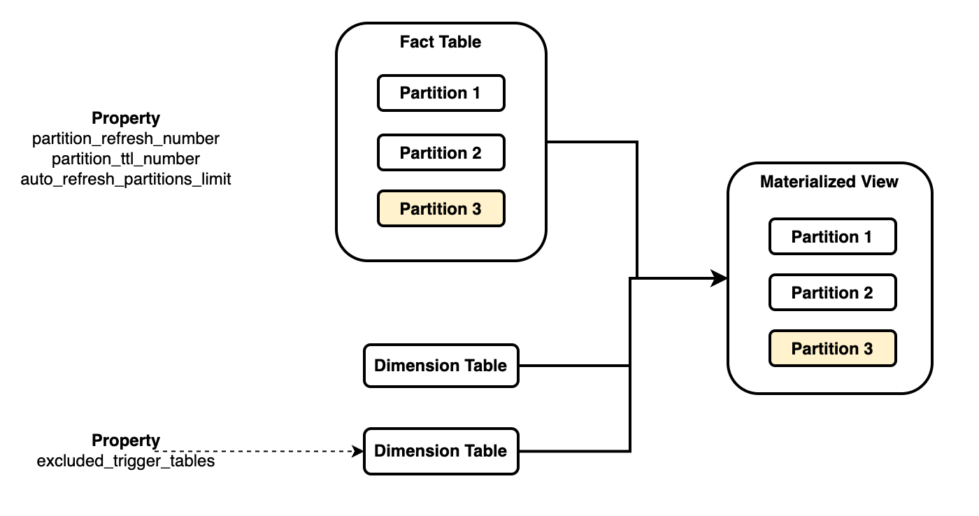

Partitioned modelingβ
In addition to layered modeling, partitioned modeling is also an essential aspect of data modeling. Data modeling often involves associating data based on business semantics and setting data's Time-To-Live (TTL) as per timeliness requirements. Partitioned modeling plays a significant role in this process.
Partitioned modeling is an essential aspect of data modeling, complementing layered modeling. It involves associating data based on business semantics and setting Time-To-Live (TTL) for data as per timeliness requirements. Data partitioning plays a significant role in this process.
Different ways of associating data give rise to various modeling approaches, such as star schemas and snowflake schemas. These models have something in common - they all use fact tables and dimension tables. Some business scenarios require multiple large fact tables, while others deal with complex dimension tables and the relationships among them. StarRocks' materialized views support partition association for fact tables, meaning that the fact table is partitioned, and the materialized view's join results are partitioned in the same way.
As the above figure shows, a materialized view associates a fact table with multiple dimension tables:
- You need to reference the partition key of a specific base table (usually the fact table) as the materialized view's partitioning key (PARTITION BY fact_tbl.col) to associate their partitioning strategies. Each materialized view can only be associated with one base table.
- When the data in a partition of the referenced table changes, the corresponding partition in the materialized view is refreshed without affecting other partitions.
- When the data in the non-referenced tables changes, the entire materialized view is refreshed by default. However, you can choose to ignore the data changes in certain non-referenced base tables so that the materialized view will not be refreshed when data in these tables changes.
Such partition association supports various business scenarios:
- Fact table updates: You can partition the fact table at a fine-grained level, such as daily or hourly. After the fact table is updated, the corresponding partitions in the materialized view are automatically refreshed.
- Dimension table updates: Usually, data updates in dimension tables will lead to the refresh of all associated results, which can be costly. You can choose to ignore the data updates in some dimension tables to avoid refreshing the entire materialized view, or you can specify a time range so that only the partitions within the time range can be refreshed.
- External table automatic refresh: In external data sources like Apache Hive or Apache Iceberg, data changes at the partition level. StarRocks' materialized views can subscribe to changes in external catalogs at the partition level, and only refresh the corresponding partition of the materialized view.
- TTL: When setting the partitioning strategy for a materialized view, you can set the number of recent partitions to retain, thus keeping only the most recent data. This is useful in business scenarios when analysts only query up-to-date data from a certain window of time, and they do not need to retain all the historical data.
Several parameters can be used to control refresh behavior:
- partition_refresh_number: the number of partitions to refresh in each refresh operation.
- partition_refresh_strategy: The refresh strategy selected for each refresh operation.
- excluded_trigger_tables: the table whose data changes can be ignored to avoid triggering the automatic refresh.
- auto_refresh_partitions_limit: the number of partitions to refresh in each automatic refresh operation.
- excluded_refresh_tables: Exclude tables that need to be refreshed, usually used together with- excluded_trigger_tables.
For more information, see CREATE MATERIALIZED VIEW.
