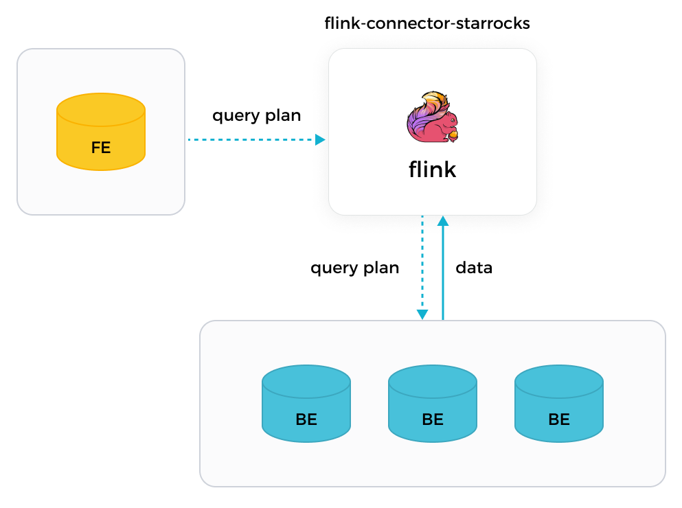

Flink connector of StarRocks
With the Flink connector of StarRocks, Flink can first obtain the query plan from the responsible FE, then distribute the obtained query plan as parameters to all the involved BEs, and finally obtain the data returned by the BEs.

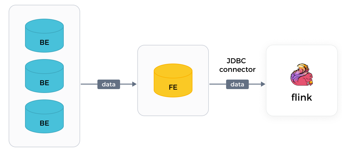

JDBC connector of Flink
With the JDBC connector of Flink, Flink can only read data from individual FEs, one at a time. Data reads are slow.
