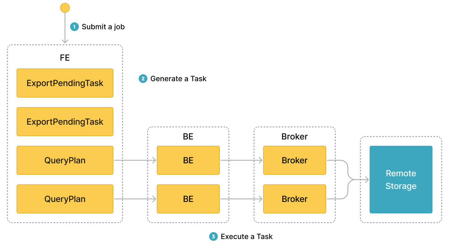

After you submit an export job, StarRocks identifies all tablets involved in the export job. Then, StarRocks divides the involved tablets into groups and generates query plans. The query plans are used to read data from the involved tablets and to write the data to a specified path of the destination storage system.
The following figure shows the general workflow.
The general workflow consists of the following three steps:
  1. The user submits an export job to the leader FE.
  2. The leader FE issues snapshot instructions to all BEs or CNs in the StarRocks cluster, so the BEs or CNs can take snapshots of the involved tablets to ensure the consistency of the data to be exported. The leader FE also generates multiple export tasks. Each export task is a query plan, and each query plan is used to process a portion of the involved tablets.
  3. The leader FE distributes the export tasks to the BEs or CNs.
