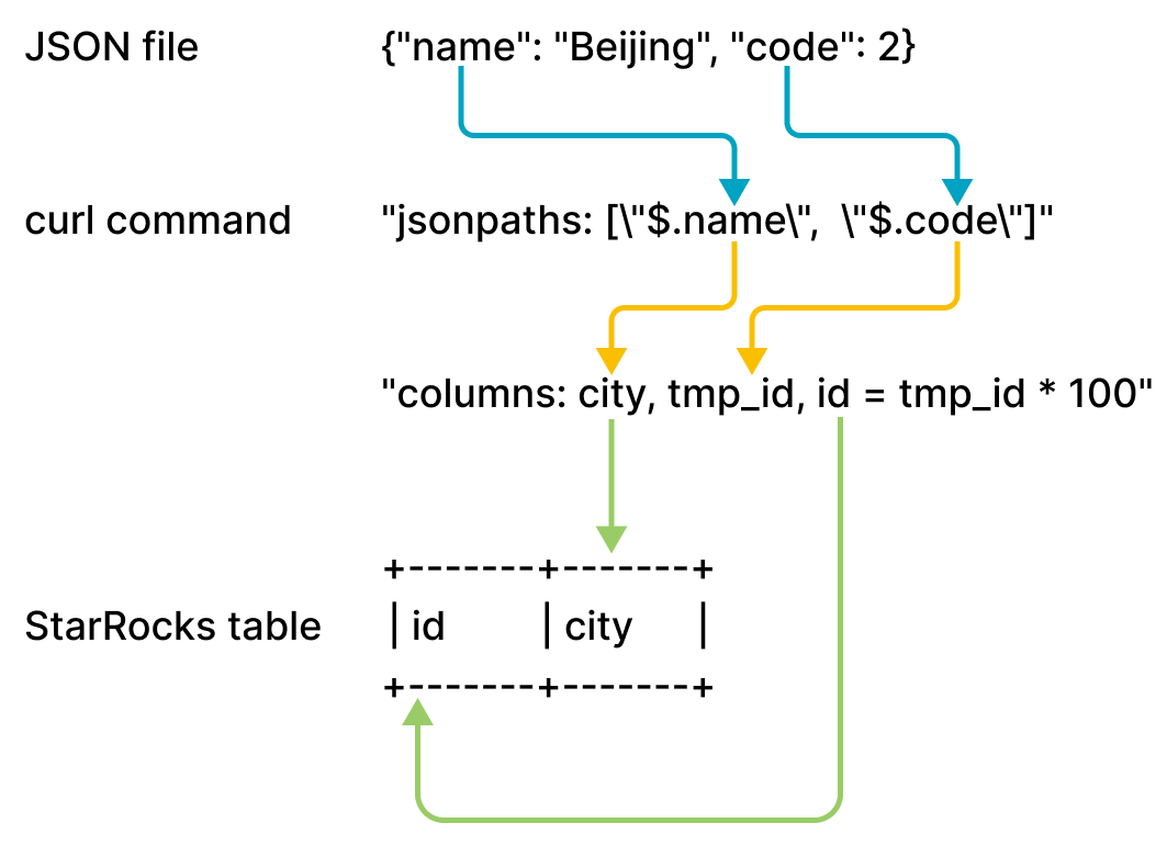

example2.json consists of two keys, name and code, which are mapped onto the id and city columns of table2, as shown in the following figure.
JSON - Column Mapping
The mappings shown in the preceding figure are described as follows:
  • StarRocks extracts the name and code keys of example2.json and maps them onto the name and code fields declared in the jsonpaths parameter.
  • StarRocks extracts the name and code fields declared in the jsonpaths parameter and maps them in sequence onto the city and tmp_id fields declared in the columns parameter.
  • StarRocks extracts the city and tmp_id fields declared in the columns parameter and maps them by name onto the city and id columns of table2.
note
In the preceding example, the value of code in example2.json is multiplied by 100 before it is loaded into the id column of table2.
For detailed mappings between jsonpaths, columns, and the columns of the StarRocks table, see the "Column mappings" section in STREAM LOAD.
