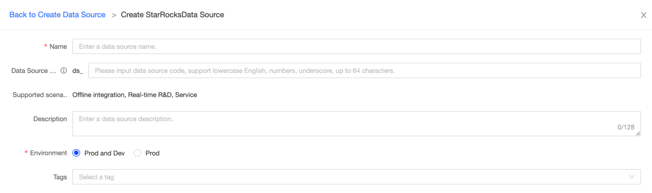

Create a StarRocks data source​
Basic information​
Create a StarRocks data source - 1
  • Name: Required. Enter a data source name. It can only contain Chinese characters, letters, numbers, underscores (_), and hyphens (-). It cannot exceed 64 characters in length.
  • Data source code: Optional. After you configure the data source code, you can use the data source code.table or data source code.schema.table format to reference the Flink SQL in the data source. If you want to automatically access the data source in the corresponding environment, use ${data source code}.table or ${data source code}.schema.table format access.
    NOTE
    Currently, only MySQL, Hologres, and MaxCompute data sources are supported.
  • Support scenerios: The scenerios that data source can be applied in.
  • Description: Optional. You can enter a brief description of the data source. A maximum of 128 characters are allowed.
  • Environment: If the business data source distinguishes between production data source and development data source, choose Prod and Dev. If the business data source does not distinguish between production and development data sources, choose Prod.
  • Tags: You can select tags to label data sources.

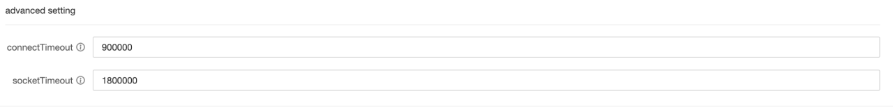

  • connectTimeout: the connectTimeout (in ms) of the database. The default value is 900000 milliseconds (15 minutes).
  • socketTimeout: the socketTimeout (in ms) of the database. The default value is 1800000 milliseconds (30 minutes).

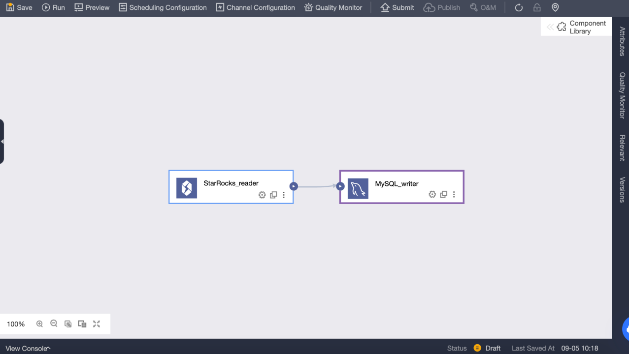

Read data from StarRocks data sources and write data to other data sources​

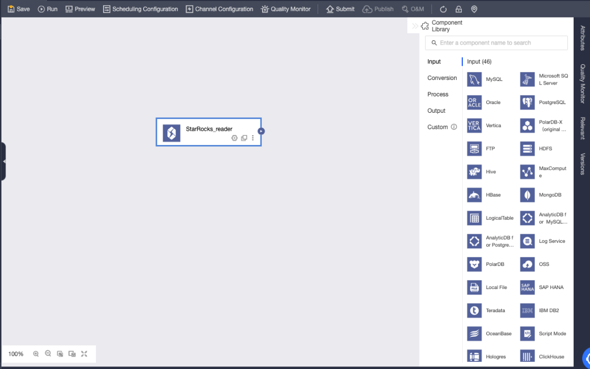

Drag the StarRocks input component to the offline integration task canvas​
Read data from StarRocks - 1

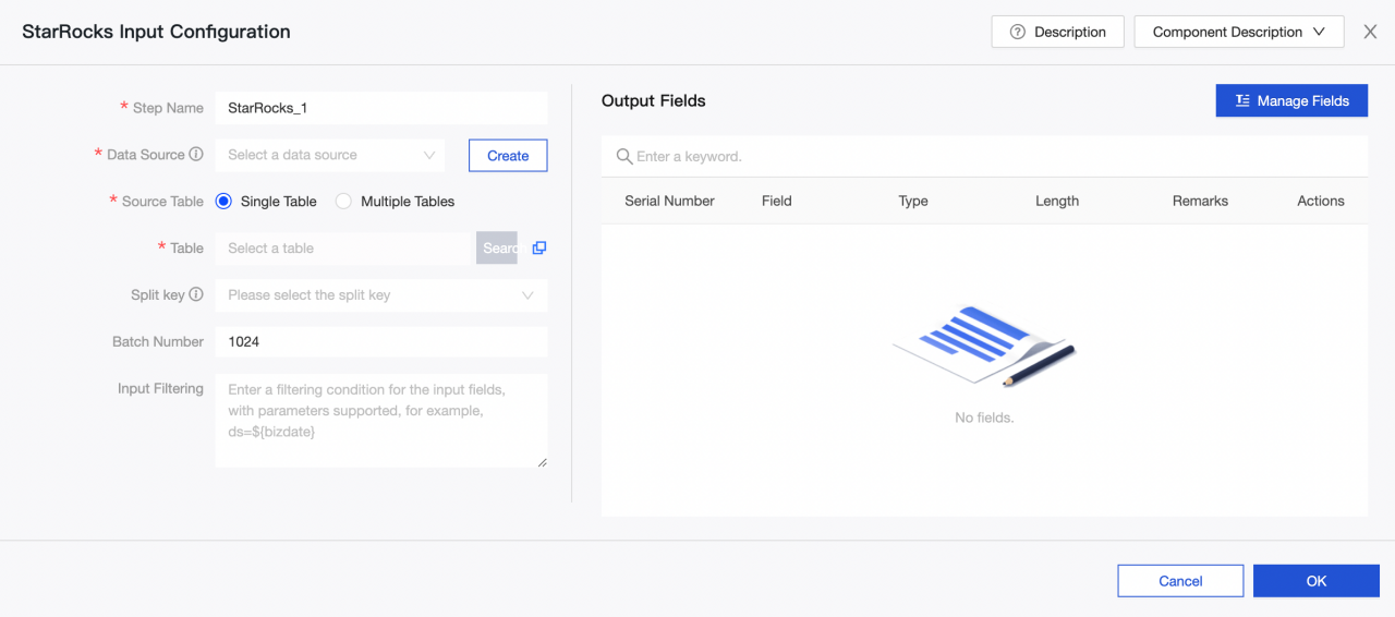

StarRocks input component configuration​
Read data from StarRocks - 2
  • Step name: Enter an appropriate name based on the scenario and location of the current component.
  • Data source: Select the StarRocks data source or project created on Dataphin. Read permission of the data source is required. If there is no satisfied data source, you can add a data source or apply for relevant permissions.
  • Source table: Select a single table or multiple tables with the same table structure as the input.
  • Table: Select the table in the StarRocks data source from the drop-down list.
  • Split key: Used with concurrency configuration. You can use a column in the source data table as the split key. It is recommended to use a primary key or an indexed column as the split key.
  • Batch number: The number of data records extracted in a batch.
  • Input Filtering: Optional.
    In the following two cases, you need to fill in the filter information:
    • If you want to filter a certain part of data.
    • If you need to incrementally append data on a daily basis or obtain full data, you need to fill in the date whose value is set as the system time of Dataphin console. For example, a transaction table in the StarRocks and the transaction creation date of it is set as ${bizdate}.
  • Output fields: List the related fields based on the input table information. You can rename, remove, add, and move the fields again. In general, fields are renamed to increase the readability of downstream data or facilitate mapping of fields during output. Fields can be removed during the input stage because relevant fields are not needed in application scenarios. The order of fields is changed to ensure that you can effectively merge data or map output data by mapping fields with different names in the same line when multiple input data are merged or output at the downstream side.

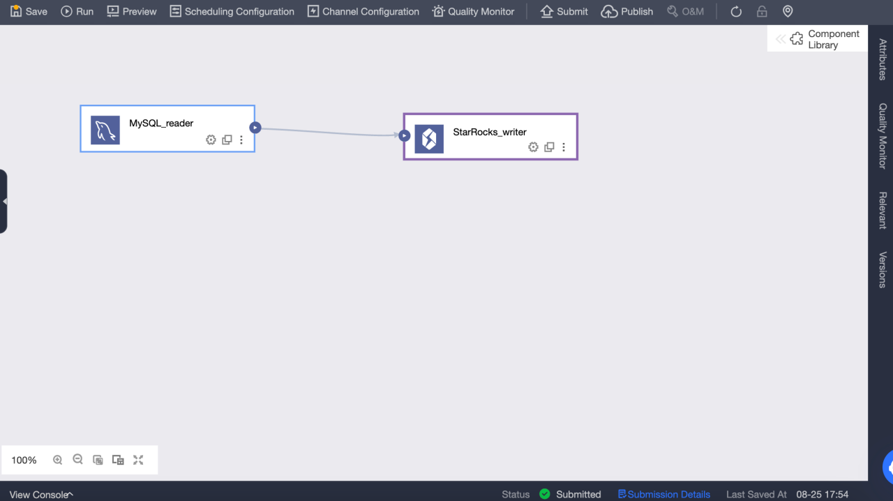

Read data from other data sources and write data to StarRocks data sources​
Configure the input component in the offline integration task, and select and configure the StarRocks output component as the destination data source​
Write data to StarRocks - 1
Configure StarRocks output component​
Write data to StarRocks - 2

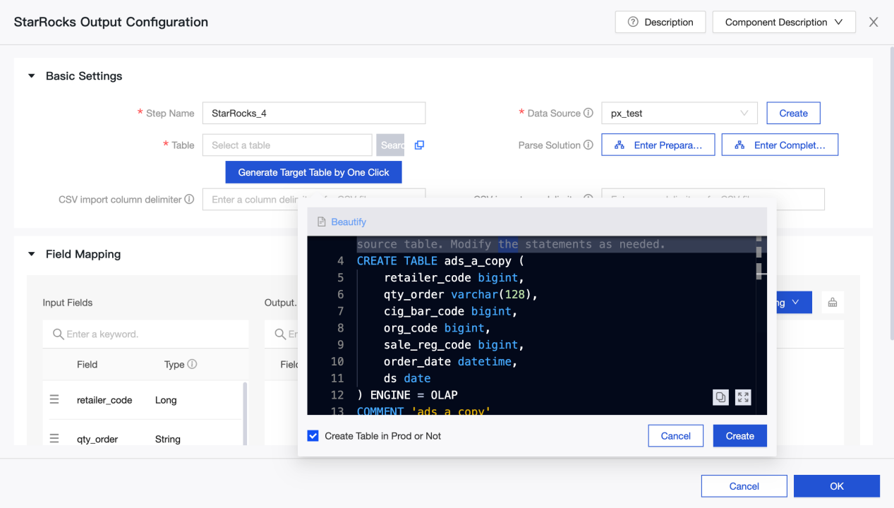

  • Generate Target Table by One Click: If you have not created a target table in StarRocks data source, you can automatically obtain the name, type, and remarks of the fields read from the upstream, and generate a table creation statement. Click to generate a target table with one click.

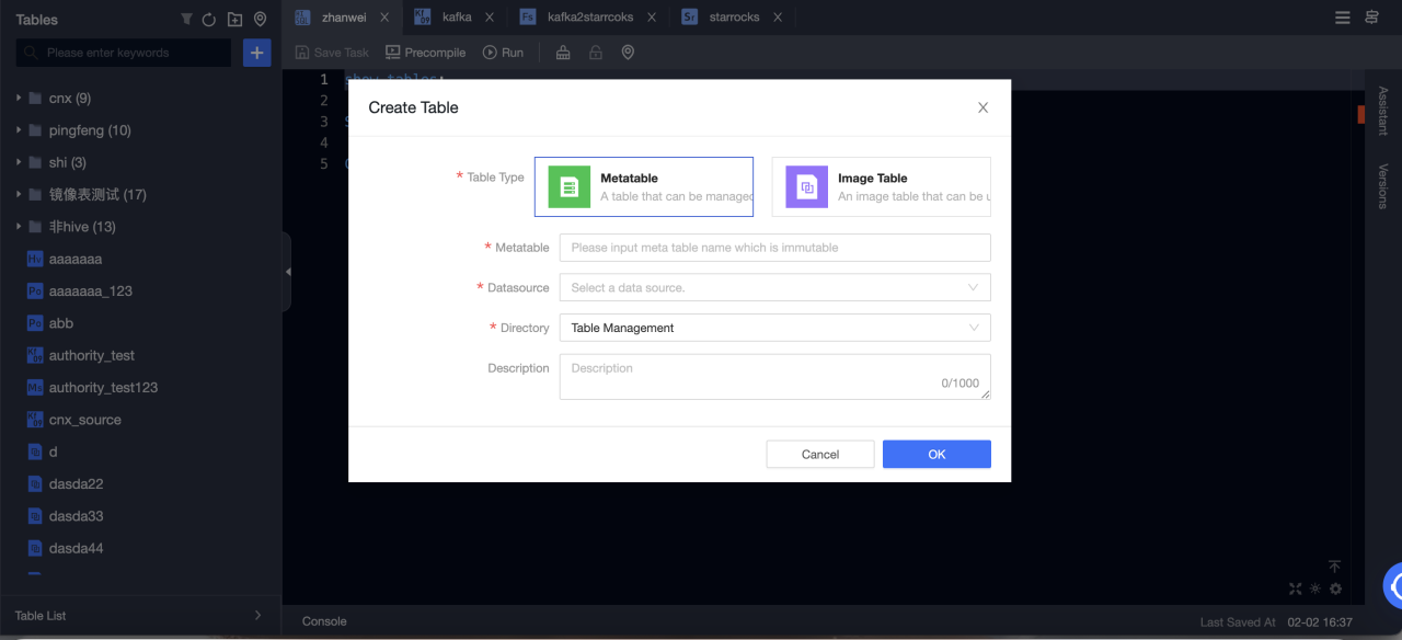

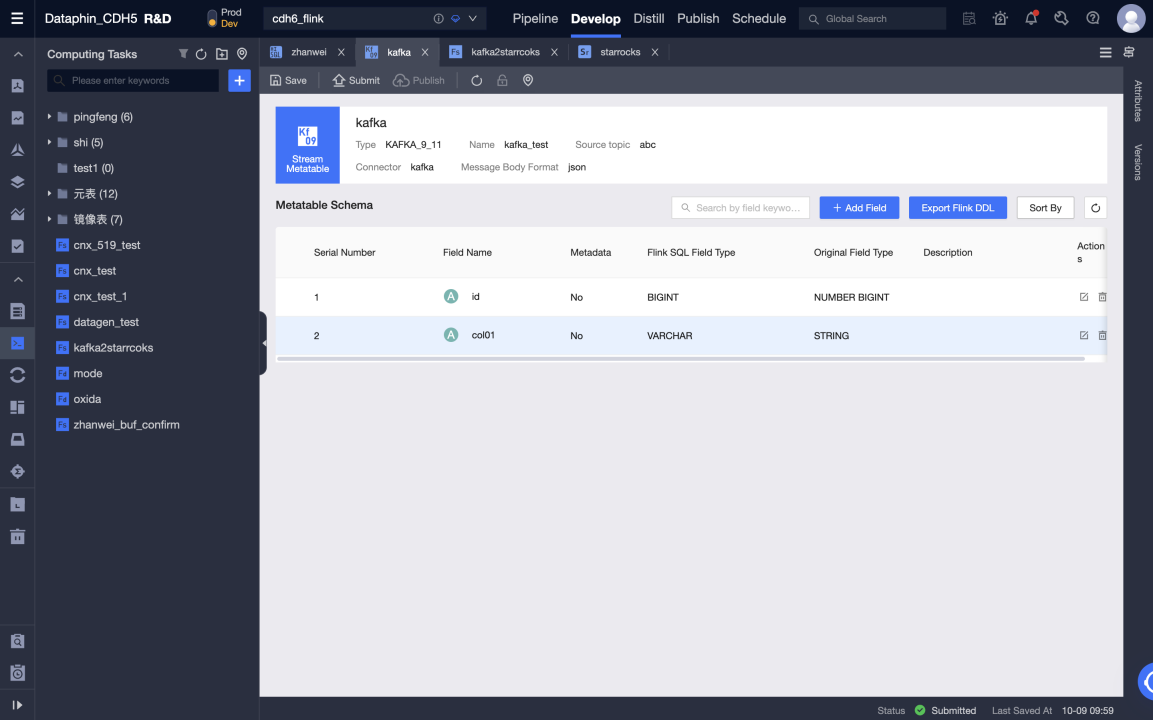

Create StarRocks meta table​
  1. Go to Dataphin > R & D > Develop > Tables.
  2. Click Create to select a real-time compute table.
    Create StarRocks meta table - 1
    • Table type: Select Metatable.
    • Metatable: Input the name of the meta table. The name immutable.
    • Datasource: Select a StarRocks data source.
    • Directory: Select the directory where you want to create a table.
    Create StarRocks meta table - 2

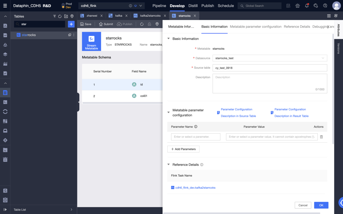

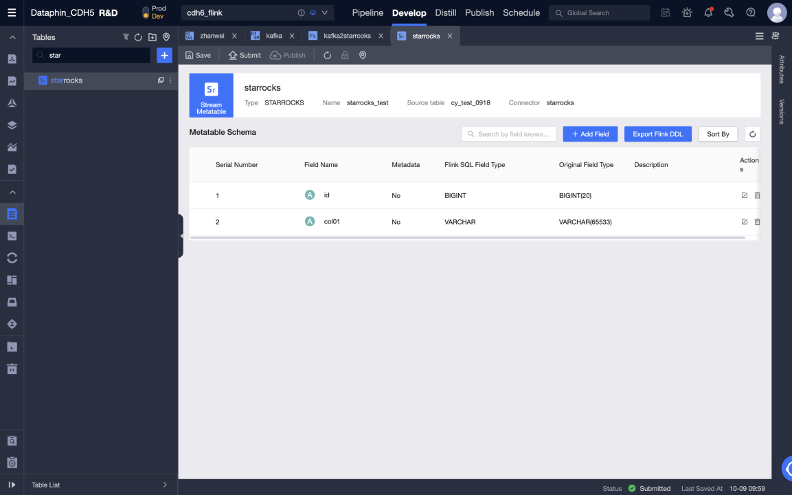

  3. After creating a meta table, you can edit the meta table, including modifying data sources, source tables, meta table fields, and configuring meta table parameters.
    Edit StarRocks meta table
  4. Submit the meta table.

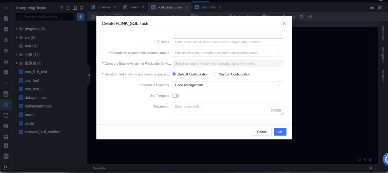

  1. Go to Dataphin > R & D > Develop > Computing Tasks.
  2. Click Create Flink SQL task.
    Create Flink SQL task - Step 2

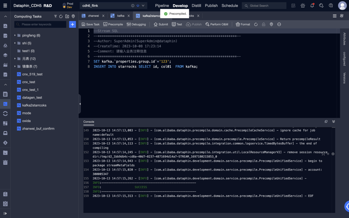

  3. Edit Flink SQL code and precompile It. Kafka meta table is used as an input table and StarRocks meta table as an output table.
    Create Flink SQL task - Step 3 - 1 ​ Create Flink SQL task - Step 3 - 2
  4. After the precompilation is successful, you can debug and submit the code.

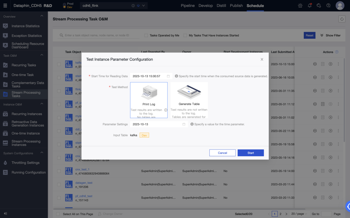

  5. Testing in the development environment can be performed by printing logs and writing test tables. The test tables can be set in Meta Tables > Properties > debugging test configurations.
    Create Flink SQL task - Step 5 - 1 Create Flink SQL task - Step 5 - 2

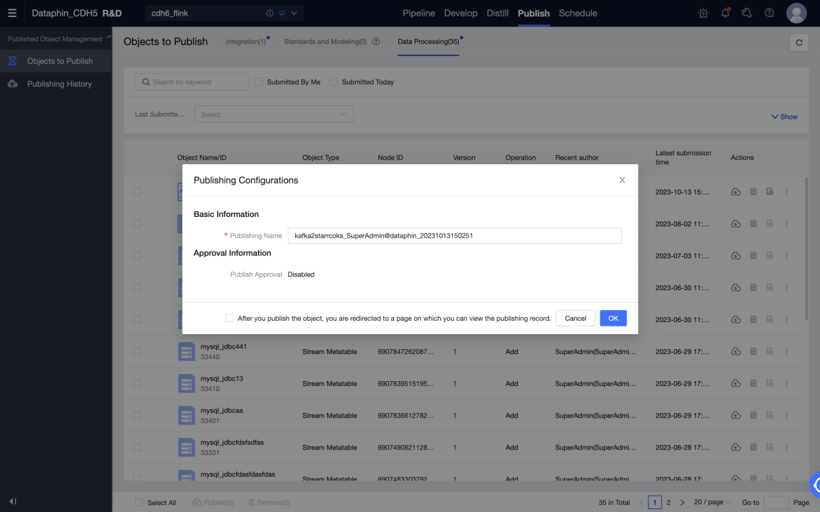

  6. After a task in the development environment runs normally, you can publish the task and the meta table used to the production environment.
    Create Flink SQL task - Step 6

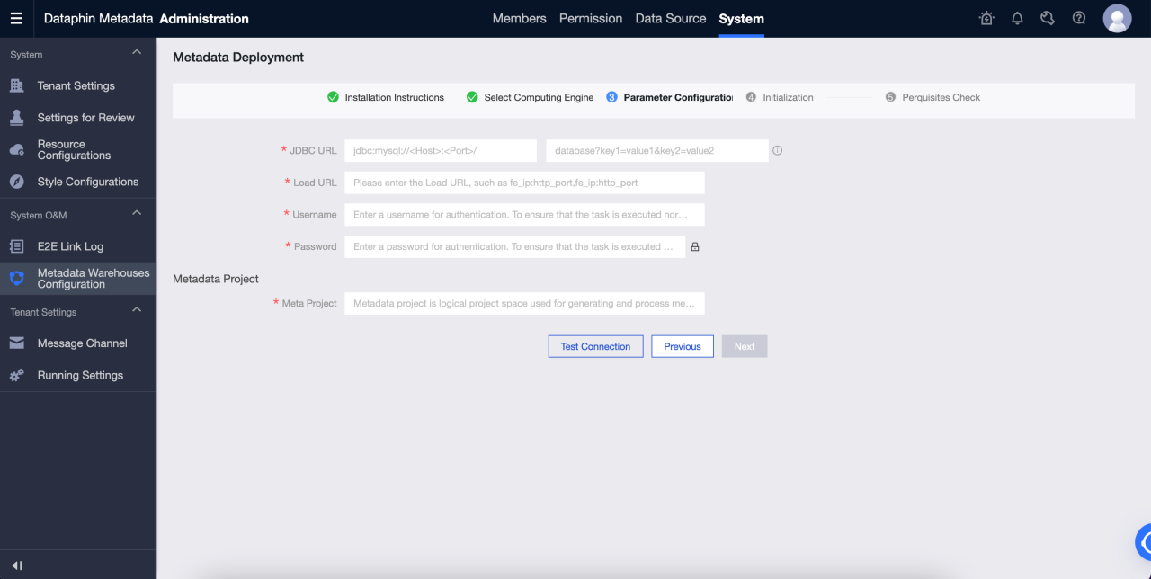

Metadata warehouse settings​
Dataphin can present and display information based on metadata, including table usage information and metadata changes. You can use StarRocks to process and calculate metadata. Therefore, you need to initialize the metadata Computing Engine (metadata warehouse) before using it. The procedure is as follows:
  1. Use an administrator account to log on to Dataphin metadata warehouse tenant
  2. Go to Administration > System > Metadata Warehouse Configuration
    a. Click Start
    b. Select StarRocks
    c. Configure the parameters. After passing the test connection, click next.
    d. Complete meta warehouse initialization
Parameters are described as follows:
  • JDBC URL: JDBC connection string, which is divided into two parts:
    • Part I: The format is jdbc:mysql://<Host>:<Port>/. Host is the IP address of the FE host in the StarRocks cluster. Port is the query Port of FE. Default value: 9030.
    • Part Two: format is database? key1 = value1 & key2 = value2, where database is the name of the StarRocks database used for metadata calculation, which is required. The parameter after '?' is optional.
  • Load URL: The format is fe_ip:http_port;fe_ip:http_port. fe_ip is host of FE (Front End), and http_port is th port of FE.
  • Username: The username used to connect to the StarRocks.
    The user need to have read and write permissions on the database specified in the JDBC URL, and must have access permissions on the following databases and tables:
    • All table in Information Schema
    • statistics.column_statistics
    • statistics.table_statistic_v1
  • Password: the password of the link of StarRocks.
  • Meta Project: The name of the project used for metadata processing in Dataphin. It is only used within the Dataphin system. We recommend that you use dataphin_meta as the project name.

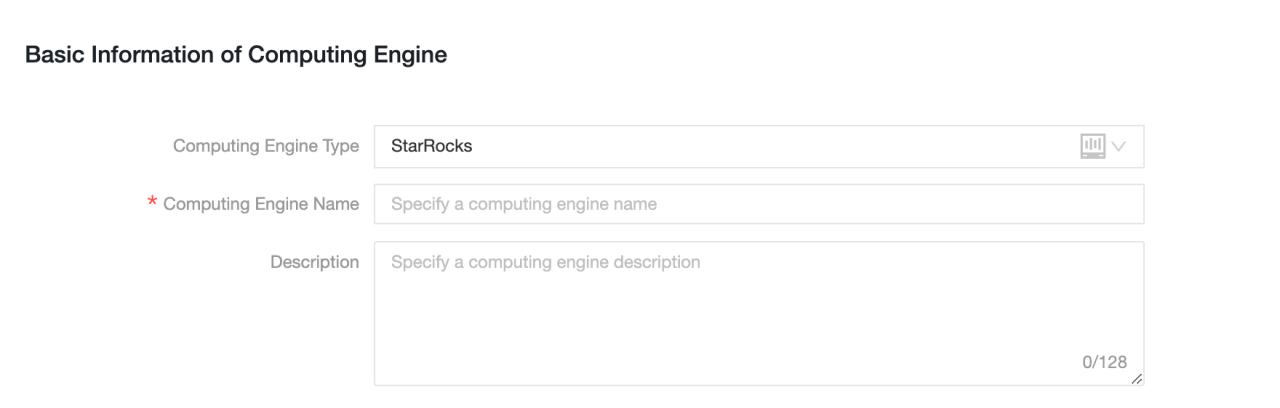

  1. Essential information
    Create compute engine - 1
    • Computing Engine Type: Select StarRocks.
    • Computing Engine Name: We recommend that you use the same name as the project to be created. For development projects, add the suffix _dev.
    • Description: Optional. Enter the description of the computing source.

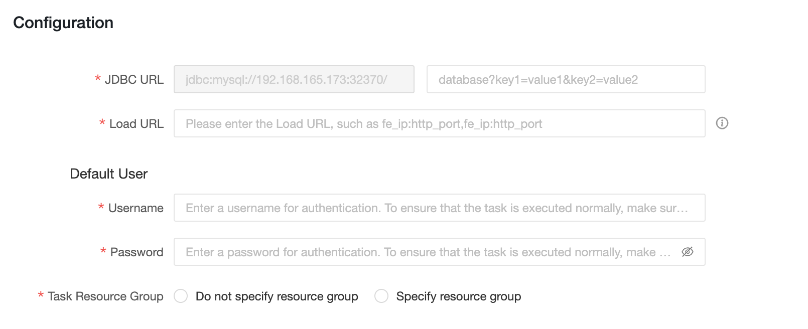

  2. Configuration information
    Create compute engine - 2
    • JDBC URL: The format is jdbc:mysql://<Host>:<Port>/. Host is the IP address of the FE Host in the StarRocks cluster. Port is the query Port of FE. Default value: 9030.
    • Password: The password of StarRocks.

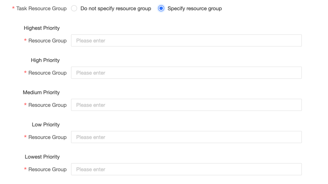

    • Task Resource Group: you can specify different StarRocks resource groups for tasks with different priorities. When you select do not specify Resource Group, the StarRocks engine determines the resource group to be executed. When you select specify Resource Group, tasks with different priorities are assigned to the specified resource group by the Dataphin.If a resource group is specified in the code of an SQL task or in the materialized configuration of a logical table, the configuration of the Resource Group of the compute source task is ignored when the task is executed.
    Create compute engine - 3

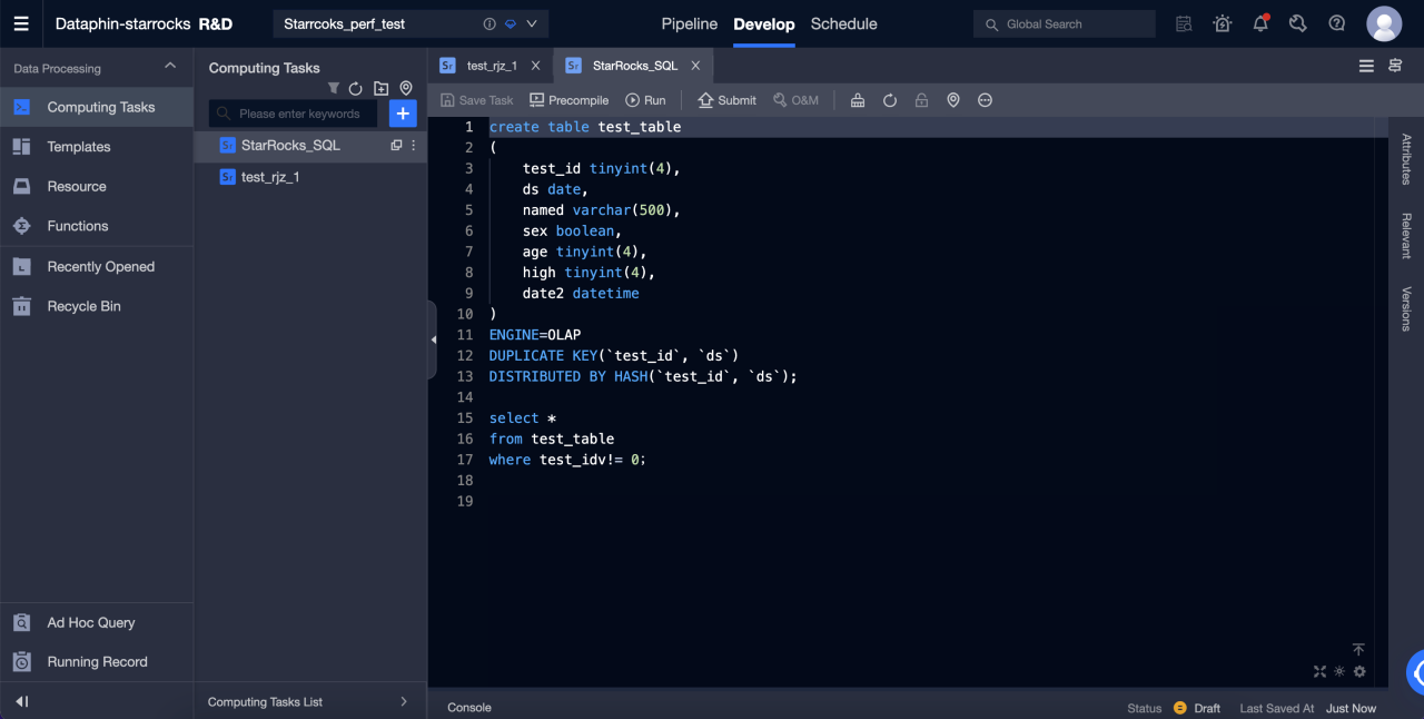

After you create a project, you can create a StarRocks SQL task to perform DDL or DML operations on the StarRocks.
The detailed steps are as follows:

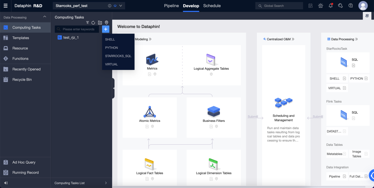

  1. Go to R & D > Develop.
  2. Click '+' in the upper-right corner to create StarRocks SQL task.
    Configure Dataphin project - 1
  3. Enter the name and scheduling type to create an SQL task.
  4. Enter SQL in the editor to start DDL and DML operations on StarRock.
    Configure Dataphin project - 2
