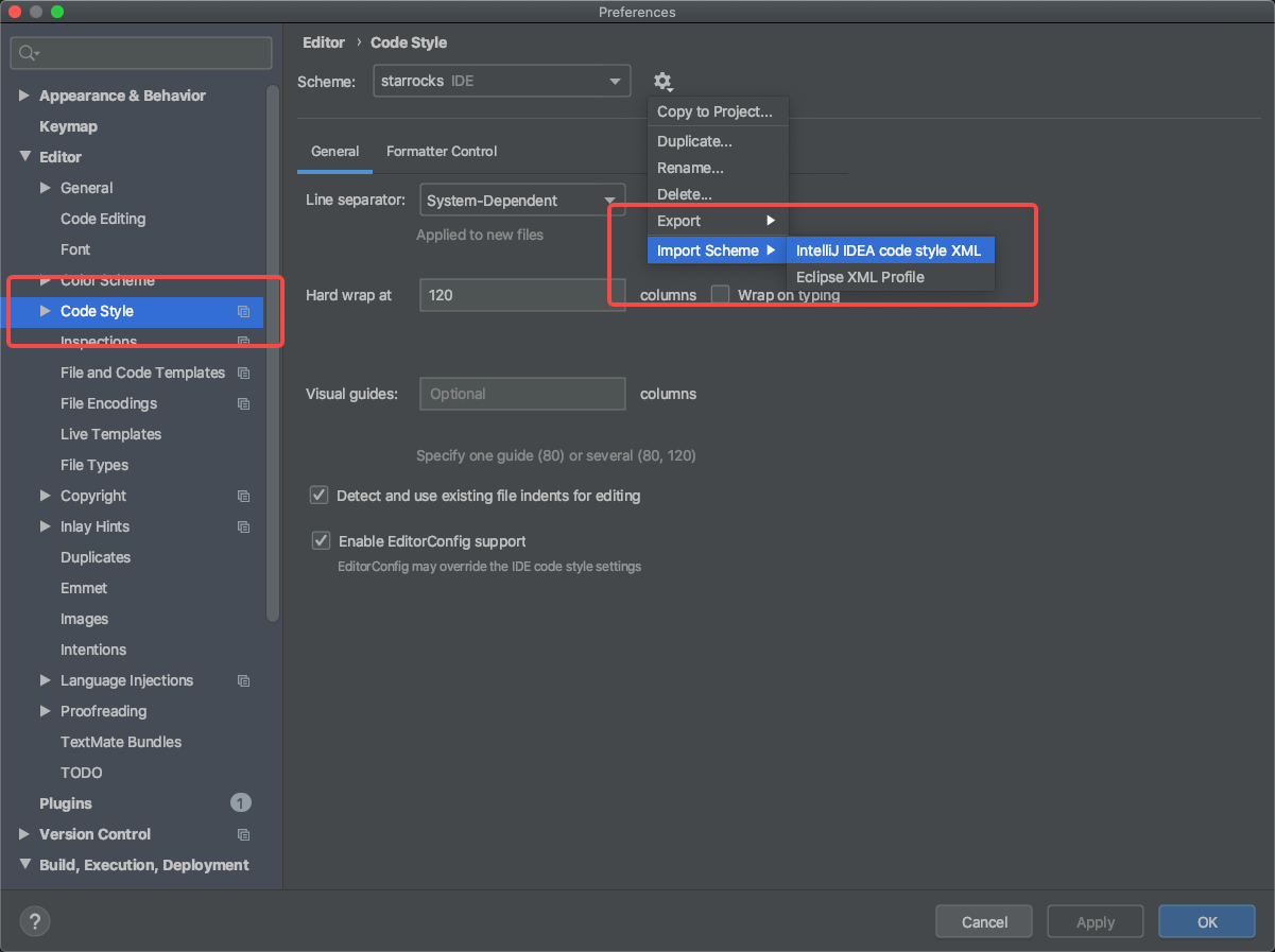

  2. Add Coding style setting To standardize the coding style, you should import the fe/starrocks_intellij_style.xml code style file in IDEA. image-20220701193938856

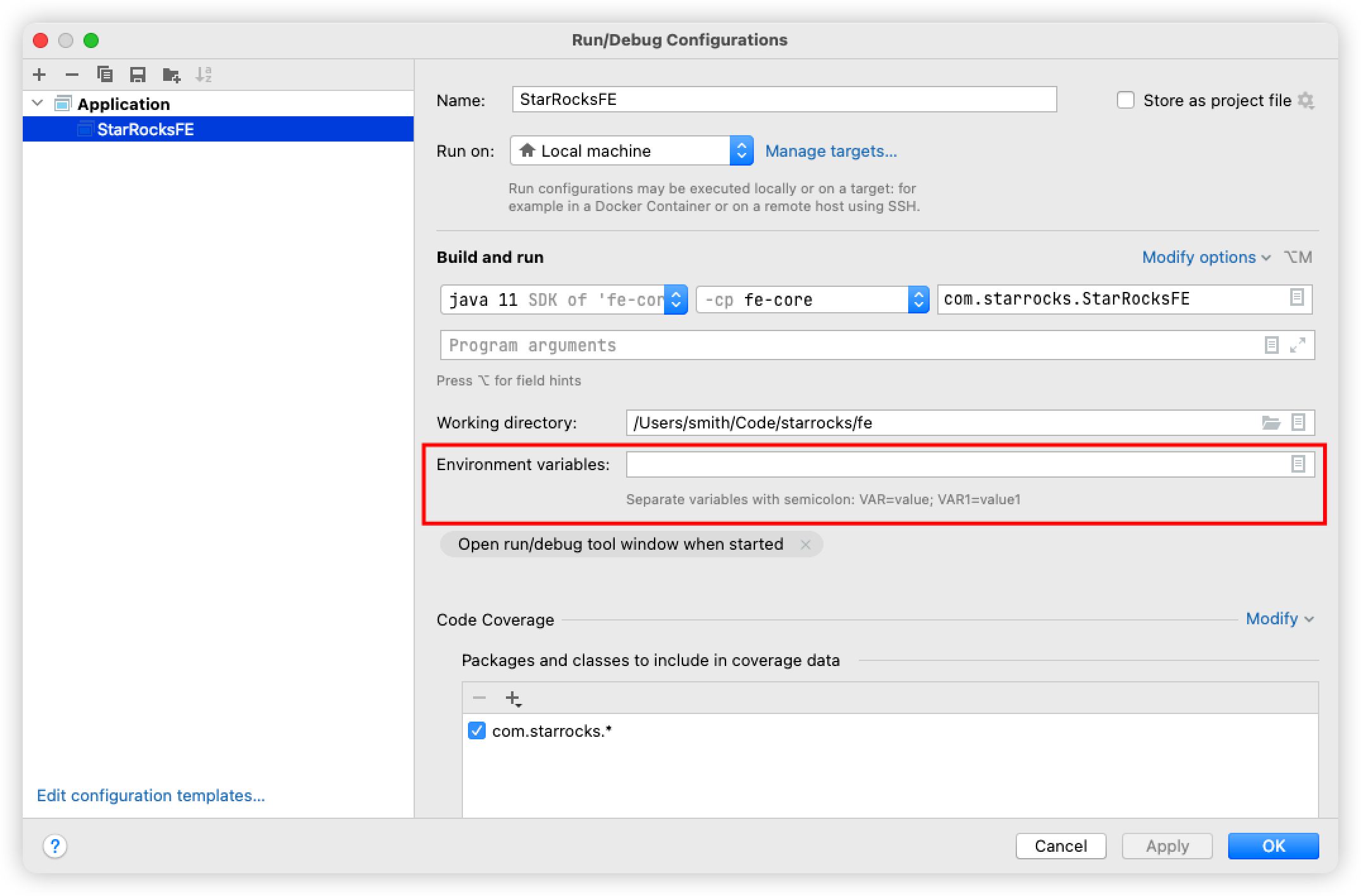

  1. Set the environment variable, as shown in the following figure:
export PID_DIR=/Users/smith/Code/starrocks/fe/bin
export STARROCKS_HOME=/Users/smith/Code/starrocks/fe
export LOG_DIR=/Users/smith/Code/starrocks/fe/log
