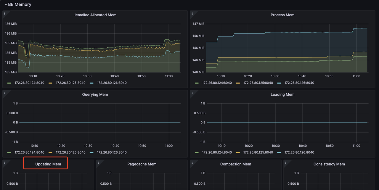

You can also monitor this update item via metrics monitor service. For example, in Grafana, you can check update item via (item in the red box):
More about Monitor and Alert with Prometheus and Grafana: https://docs.starrocks.io/docs/administration/management/monitoring/Monitor_and_Alert/
