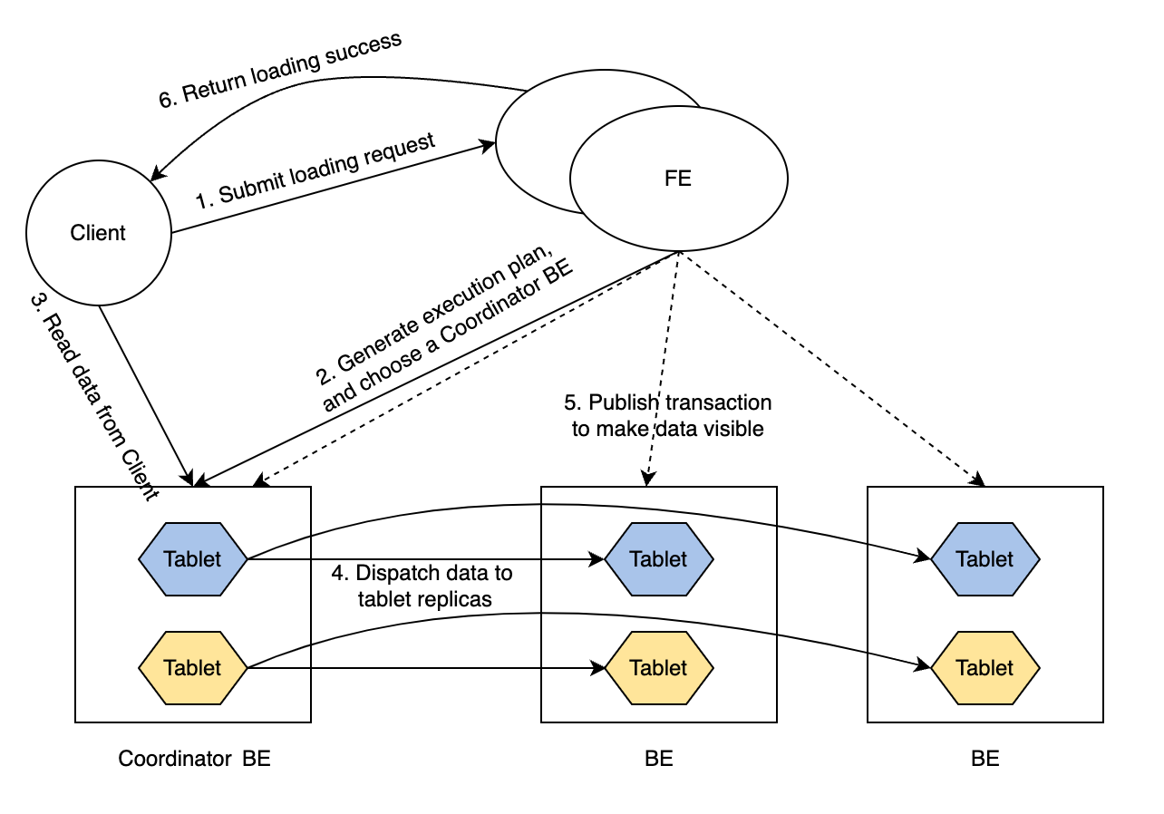

Loading data into a multi-replica table​
Replica-1
The routine of a loading transaction is as follows:
  1. The client submits a loading request to FE.
  2. FE chooses a BE node as the Coordinator BE node of this loading transaction, and generates an execution plan for the transaction.
  3. The Coordinator BE node reads the data to be loaded from the client.
  4. The Coordinator BE node dispatches the data to all the replicas of tablets.
    NOTE
    A tablet is a logical slice of a table. A table has multiple tablets, and each tablet has replication_num replicas. The number of tablets in a table is determined by the bucket_size property of the table.
  5. After the data is loaded and stored in all the tablets, FE makes the loaded data visible.
  6. FE returns loading success to the client.
Such a routine guarantees service availability even under extreme scenarios.

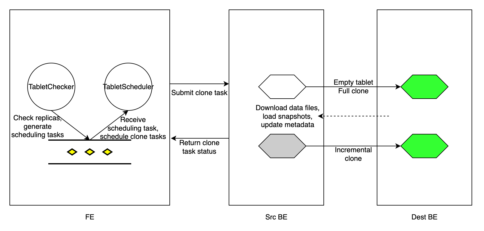

Automatic replica repair​
Replicas can fail because certain BE nodes crash or some loading tasks fail. StarRocks automatically repairs these failed replicas.
Every tablet_sched_checker_interval_seconds, default 20 seconds, Tablet Checker in FE scans all tablet replicas of all tables in your StarRocks cluster, and judges if a replica is healthy by checking the version number of the currently visible data and the health status of the BE node. If the visible version of a replica lags behind those of the other replicas, StarRocks performs an incremental clone to repair the failed replica. If a BE node fails to receive heartbeats or is dropped from the cluster, or the replica is too lagged to be repaired by an incremental clone, StarRocks performs a full clone to repair the lost replica.
After detecting tablet replicas that need repair, FE generates a tablet scheduling task, and adds the task to the scheduling task queue. Tablet Scheduler in the FE receives the scheduling task from the queue, creates clone tasks for each failed replica in accordance with the clone type they need, and assigns the tasks to the executor BE nodes.
A clone task is essentially copying data from a source BE node (which has a healthy replica), and loading the data into the destination BE node (which has a failed replica). For a replica with a lagged data version, FE assigns an incremental clone task to the BE executor that stores the failed replica, and informs the executor BE node from which peer BE node it can find a healthy replica and clone the new data. If a replica is lost, FE chooses a surviving BE node as the executor BE node, creates an empty replica in the BE node, and assigns a full clone task to the BE node.
For each clone task, regardless of its type, the executor BE node duplicates the physical data files from a healthy replica, and then updates its metadata accordingly. After the clone task is completed, the executor BE node reports task success to Tablet Scheduler in FE. After removing the redundant tablet replicas, FE updates its metadata, marking the completion of the replica repair.
Replica-2
During tablet repair, StarRocks can still execute queries. StarRocks can load data into the table as long as the number of healthy replicas satisfies write_quorum.
