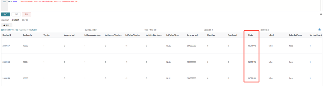

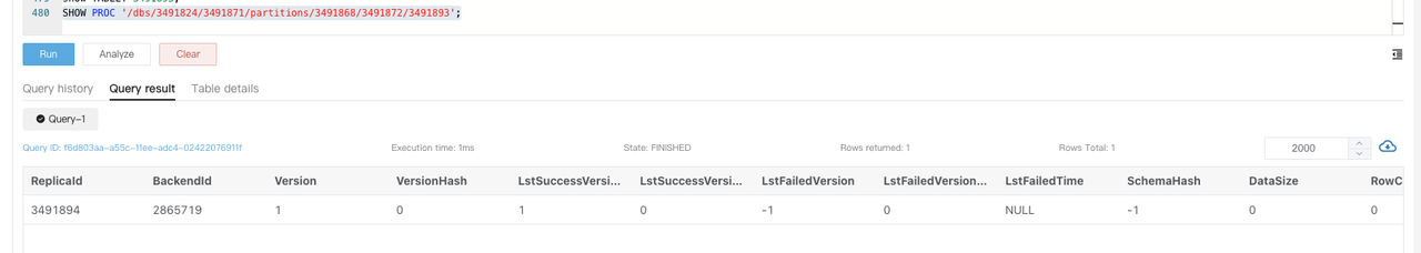

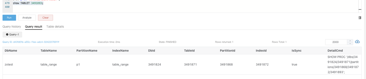

Use the following command to check the tablet with excessive versions:
SELECT BE_ID,TABLET_ID FROM information_schema.be_tablets WHERE NUM_ROWSET>700;
Example for Tablet with ID 2889156:
SHOW TABLET 2889156;
Execute the command returned in the DetailCmd field:
SHOW PROC '/dbs/2601148/2889154/partitions/2889153/2889155/2889156';
show proc replica
Under normal circumstances, as shown, all three replicas should be in NORMAL status, and other metrics like RowCount and DataSize should remain consistent. If only one replica exceeds the version limit of 700, you can trigger a Clone task based on other replicas using the following command:
ADMIN SET REPLICA STATUS PROPERTIES("tablet_id" = "$tablet_id", "backend_id" = "$backend_id", "status" = "bad");

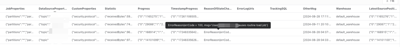

  2. If any Routine Load task is in the PAUSED state, examine the ReasonOfStateChanged, ErrorLogUrls, and TrackingSQL fields. Typically, executing the SQL query in TrackingSQL can reveal the specific error.
    Example:
    Tracking SQL
  3. If the Routine Load task status is RUNNING, you can try to increase the task’s concurrency. The concurrency of individual Routine Load jobs is determined by the minimum value of the following four parameters:

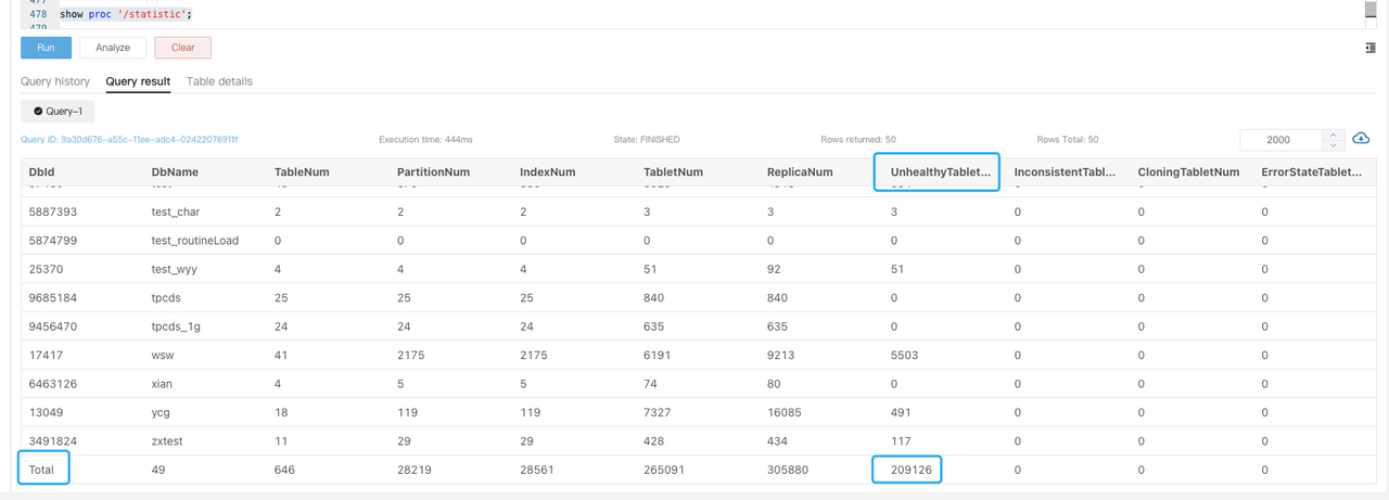

    1. If a tablet is in a non-normal state, search the be.WARNING logs for tablet is not normal and execute SHOW PROC '/statistic' to check the cluster-level UnhealthyTabletNum.
      show statistic

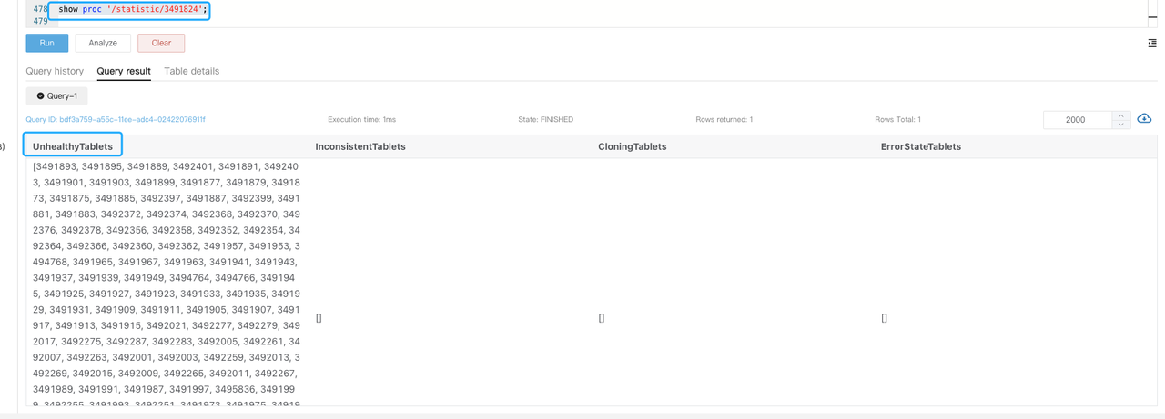

    2. Execute SHOW PROC '/statistic/$DbId' to check the unhealthy tablet number in the specified database.
      show statistic db
    3. Execute SHOW TABLET $tablet_id to view the table information of the corresponding tablet.
      show tablet
    4. Execute the command returned in the DetailCmd field to identify the cause of the unhealthy tablets.
      show proc
    Typically, unhealthy as well as inconsistent replicas are usually caused by high-frequency loading, where the progress of writes to different replicas is not synchronized. You can check if the table has a large number of real-time writes and reduce the number of abnormal replicas by reducing the frequency of loading or temporarily suspending the service and retrying the task thereafter.

  4. Investigate the cause of the refresh failure.
    SELECT * FROM information_schema.task_runs WHERE task_name ='mv-112517' \G
