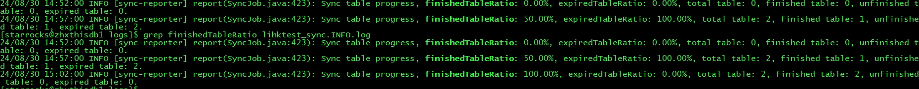

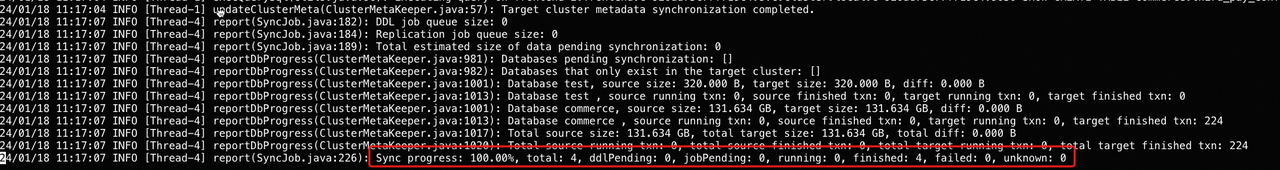

View Migration Tool logsβ
You can check the migration progress through the migration tool log log/sync.INFO.log.
Example 1: View task progress.
The important metrics are as follows:
- Sync job progress: The progress of data migration. The migration tool regularly checks whether the data in the target cluster is lagging behind the source cluster. Therefore, a progress of 100% only means that the data synchronization is completed within the current check interval. If new data continues to be loaded into the source cluster, the progress may decrease in the next check interval.
- total: The total number of all types of jobs in this migration operation.
- ddlPending: The number of DDL jobs pending to be executed.
- jobPending: The number of pending data synchronization jobs to be executed.
- sent: The number of data synchronization jobs sent from the source cluster but not yet started. Theoretically, this value should not be too large. If the value keeps increasing, please contact our engineers.
- running: The number of data synchronization jobs that are currently running.
- finished: The number of data synchronization jobs that are finished.
- failed: The number of failed data synchronization jobs. Failed data synchronization jobs will be resent. Therefore, in most cases, you can ignore this metric. If this value is significantly large, please contact our engineers.
- unknown: The number of jobs with an unknown status. Theoretically, this value should always be- 0. If this value is not- 0, please contact our engineers.
Example 2: View the table migration progress.
- Sync table progress: Table migration progress, that is, the ratio of tables that have been migrated in this migration task to all the tables that need to be migrated.
- finishedTableRatio: Ratio of tables with at least one successful synchronization task execution.
- expiredTableRatio: Ratio of tables with expired data.
- total table: Total number of tables involved in this data migration progress.
- finished table: Number of tables with at least one successful synchronization task execution.
- unfinished table: Number of tables with no synchronization task execution.
- expired table: Number of tables with expired data.
