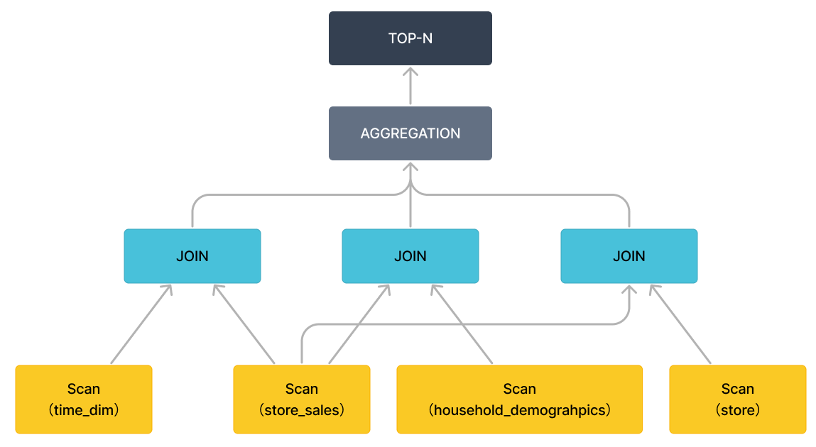

The query plan of Query 96 is divided into five fragments, numbered from 0 to 4. The query plan can be read one by one in a bottom-up manner.
Fragment 4 is responsible for scanning the time_dim table and executing the related query condition (i.e. time_dim.t_hour = 8 and time_dim.t_minute >= 30) in advance. This step is also known as predicate pushdown. StarRocks decides whether to enable PREAGGREGATION for aggregation tables. In the previous figure, preaggregation of time_dim is disabled. In this case, all dimension columns of time_dim are read, which may negatively affect performance if there are many dimension columns in the table. If the time_dim table selects range partition for data division, several partitions will be hit in the query plan and irrelevant partitions will be automatically filtered out. If there is a materialized view, StarRocks will automatically select the materialized view based on the query. If there is no materialized view, the query will automatically hit the base table (for example, rollup: time_dim in the previous figure).
When the scan is complete, Fragment 4 ends. Data will be passed to other fragments, as indicated by EXCHANGE ID : 09 in the previous figure, to the receiving node labeled 9.
For the query plan of Query 96, Fragment 2, 3, and 4 have similar functions but they are responsible for scanning different tables. Specifically, the Order/Aggregation/Join operations in the query are performed in Fragment 1.
Fragment 1 uses the BROADCAST method to perform Order/Aggregation/Join operations i, that is, to broadcast the small table to the large table. If both tables are large, we recommend that you use the SHUFFLE method. Currently, StarRocks only supports HASH JOIN. The colocate field is used to show that the two joined tables are partitioned and bucketed in the same way, so that the join operation can be performed locally without migrating the data. When the Join operation is complete, the upper-level aggregation, order by, and top-n operations will be performed.
By removing the specific expressions (only keep the operators), the query plan can be presented in a more macroscopic view, as shown in the following figure.

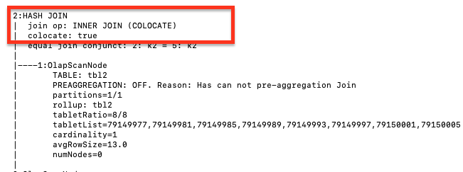

  • Colocate Join
    If tables A and B belong to the same Colocation Group which is specified during table creation, the data rows with the same bucketing key values from tables A and B are distributed on the same BE node. When the Join equijoin expression contains the bucketing key of tables A and B in the Join query, you can hint the Join execution method as Colocate Join. Data with the same key values are directly joined locally, reducing the time spent on data transmission between nodes and improving query performance.
    select k1 from t1 join [COLOCATE] t2 on t1.k1 = t2.k2 group by t2.k2;
View Join execution method
Use the EXPLAIN command to view the actual Join execution method. If the returned result shows that the Join execution method matches the Join hint, it means that the Join hint is effective.
EXPLAIN select k1 from t1 join [COLOCATE] t2 on t1.k1 = t2.k2 group by t2.k2;
